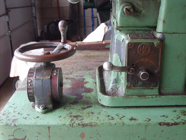

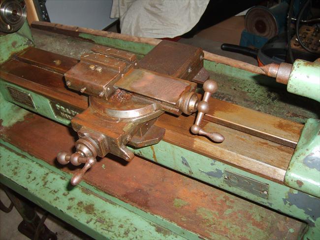

This is the second P&W lathe I acquired of the same model. It is complete with original maple top bench,full set of collets, a couple chucks and various backplates and tooling. Later model than my first one, motor is Master Speed Ranger 3 phase, 3/4 HP, four speed (slow & fast x forward and reverse.) Tiny blue property tag on power switch box says it belonged at one point to Farberware, from kitchen utensils fame.Dirty and grimy as found, started slow restoration process.
as found condition in traditional garage door shot
my camera
Variable speed 250 to 2250, actuated via flexible cable. Motor controls on the right, integral to bed
Despite looks, everything moves just right
After stripping a few layers
4 v belts go to motor underneath
cam lock spindle, massive bed relative to size
