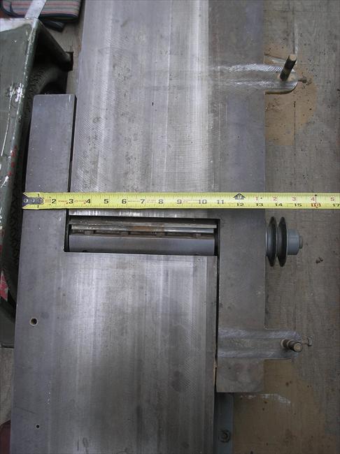

rear view showing table elevation and fence studs
symmetrical in and outfeed tables permit jointing overwidth boards (after removing the studs)

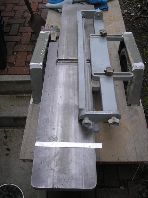

arriving. 12" ruler for scale
