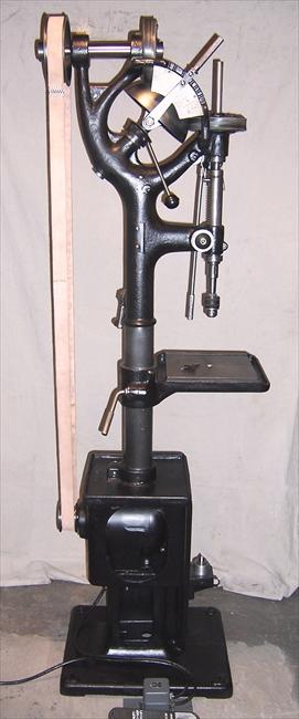

RH view. The motor shown was replaced with a vintage cast iron, Babbitt bearing 3/4hp Master motor that fit perfectly to the mounts in the base cavity.

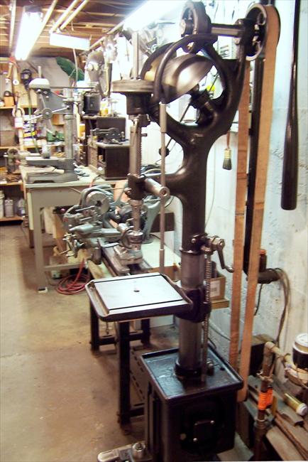

Up and running in my shop.

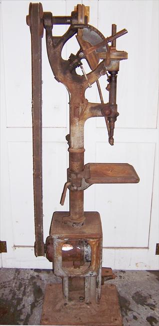

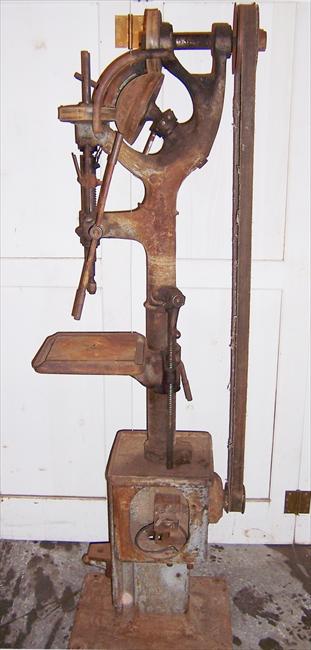

LH view. "As purchased" condition showing the extent of surface rust, grime and crud to be removed. Many hours were spent on disassembly and cleaning with just about every tool and technique available in my shop.

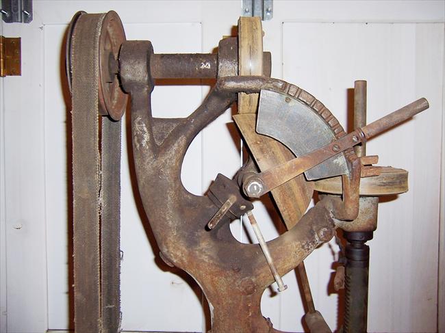

Left close view of the variable speed drive system as purchased.

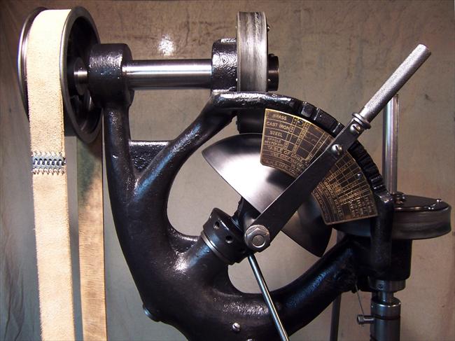

After restoration. The brass plate is a chart showing the recommended speed settings for drill bits up to 1/2" when drilling brass, cast iron and steel.
