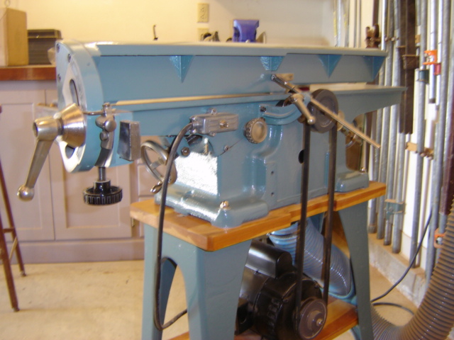

Purchased From a Craigslist ad. Did a complete tear-down, new bearings, new cherry tables, new paint. The motor was moved from the rear mounting to bottom mount to save space and make the jointer less top heavy. Added a dust collection port on the bottom of the table. Has the optional dual purpose blade guard instead of the pork chop guard, but the small part for jointing thin strips is missing. The badge reads Walker Turner, division, Kearney Trecker, dating the machine to approx. 1948-1956.
