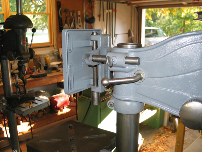

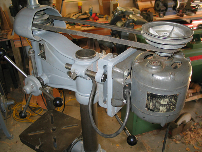

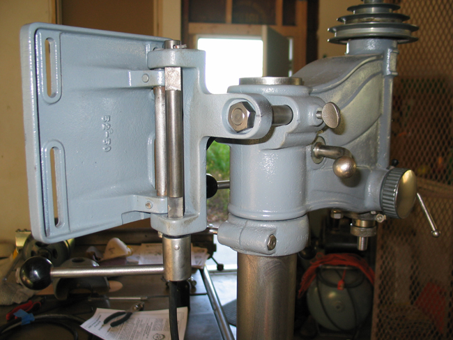

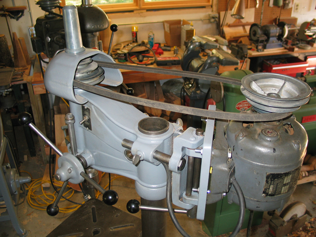

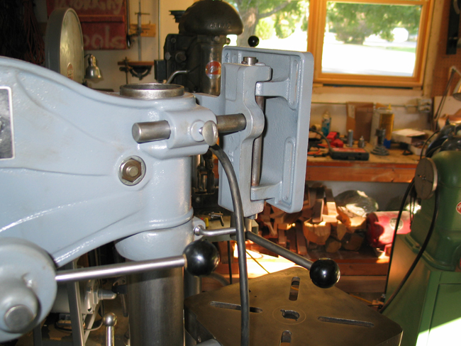

Description/Model: 52-50A Quick Change Release
Last Updated 10/11/2010 9:20:22 AM
Installed on my model 73 drill press.
From the catalog description:
“Permits instant release of belt tension, speeds up belt changes, and assures correct tension adjustment at all times. Motor, on hinged base, is moved toward the drill press head by rocker shaft with ball handle control. Easily installed, replacing regular motor bracket."
