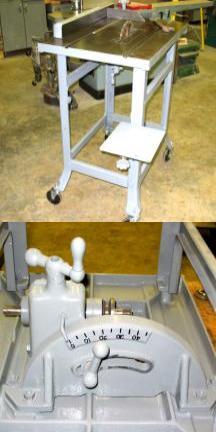

This is a very nice table saw that I aquired from an old garage. All I have done to this saw is wire brush it and paint it. There was no rust. The top measures 30 x 21 13/16", cast iron top, machined with slight grooving in the line of travel. Machined into the top are lines for setting sliding T-square to 90 degrees and 45 degrees. The trunnion is very large and has a 6" radius of travel. Adjustable stops at 90 and 45 degrees. The legs are cast iron standing 33 3/4" to the top of the table. It has a 3/4" arbor. The drive pulley and saw blade back plate are machined as one piece. The right hand end of the shaft does not appear to be used for anything. There are four stub bolts holding the carriage and trunnion in place. I have set up hundreds of table saw tops and this was by far the easiest saw I have ever set up, the same with the fence.
Casters are only for moving around while working on it.
Lonnie, image of actual saw.
