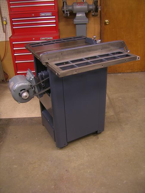

Found this saw via Craigslist. The saw had been stored in a shelter outside, and had quite a bit of corrosion as a result. I completely disassembled and refinished it. I added a magnetic starter and NOS Allen Bradley switch. The saw is missing the belt guard and the original feet/casters. I built a new mobile base for the saw. I use the saw regularly for general remodeling work, and it has never let me down. Well worth the effort.
