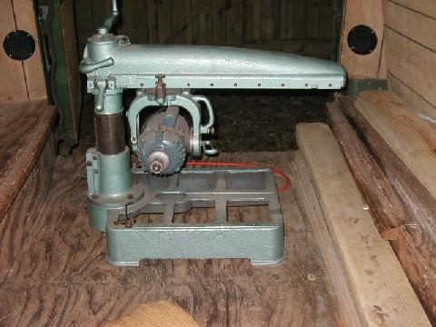

Saw in back of my van showing cast iron base.

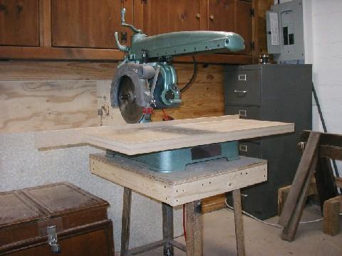

Saw with cast iron base sitting on temporary table.

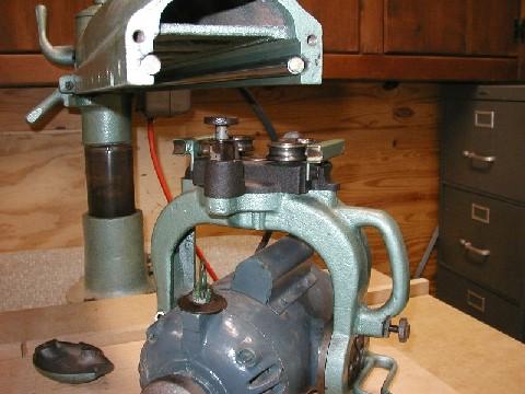

End of arm showing rails and concaved roller head bearings.
