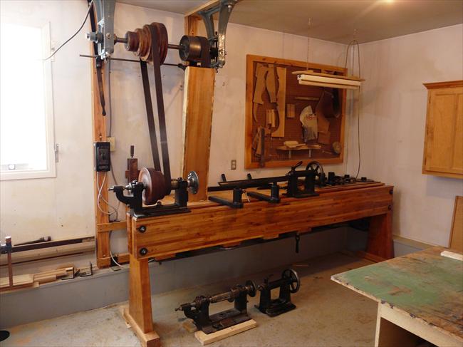

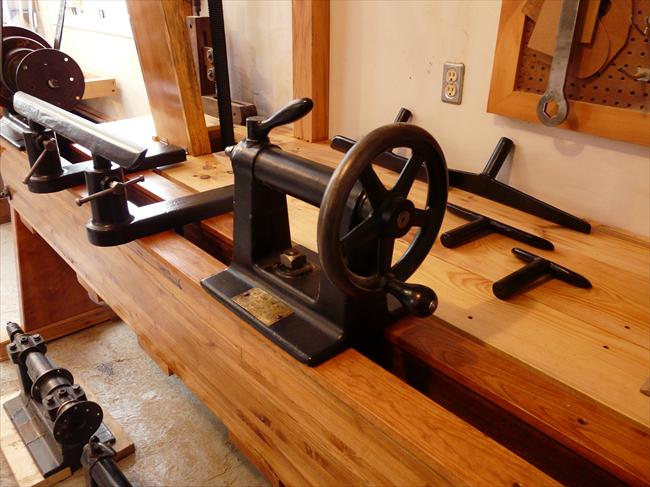

I have bought the lathe this spring 2009 the my neighbour.Since 30 years ago the lathe had been storage in his garage. On the floor I rebuit another C,M,C lathe that acquired from Brian Garcia

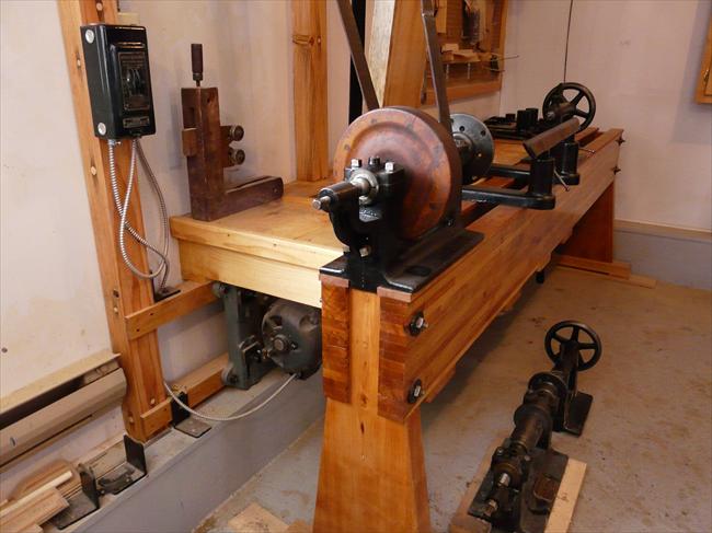

I have sanding and varnish the11 feets ash and birch lathe frame and put the new cherry runner

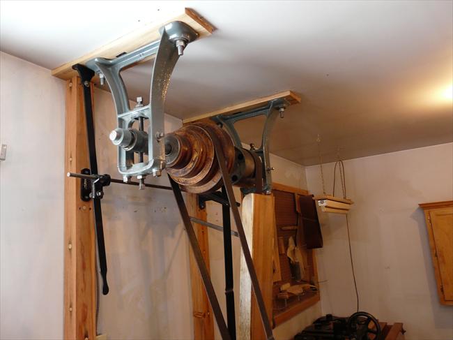

the original hanger is broken .I used the Forano hanger with Fafnir box bearing

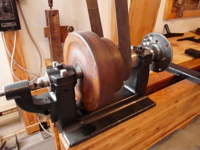

The head stock babbitt bearing is original and excelent condition
The 1.5 hp General Electrique had been instaled about 1940
Sold by Williams&Wilson ,Montreal Quebec
