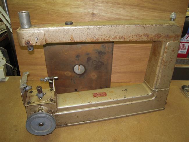

Craftsman/King-Seeley Central Specialty Power-Bronze 18" belt driven scroll saw from the early 1960s.
The saw is missing the spring cap, upper guide and hold-down foot assembly.
The tilt adjustment lever is broken and the pulley is bent.

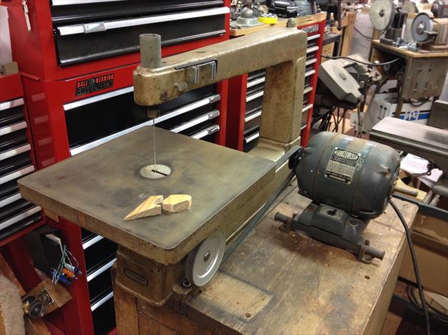

Cleaned crankcase and filled with Valvoline SAE30 non-detergent oil.
Installed replacement 4" saw pulley.
Adjusted saw and installed 6" Craftsman blade.

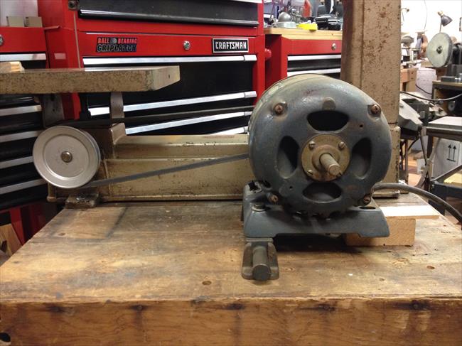

Mounted to test stand with a Dunlap 1/3hp 1750rpm ball bearing motor and 2¼" steel pulley.
Craftsman pivot motor mount and clips.
Tested--runs extremely smooth.

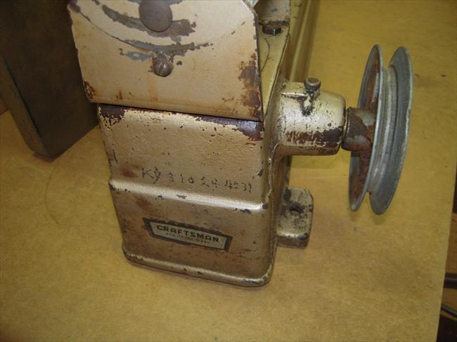

Front view with Craftsman "Crown" logo
(S/A above)

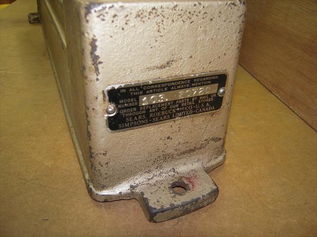

Obligatory tag shot
(S/A above)
Test run. Magnets on arm hold blade attachment & guide adjustment hex wrenches.
iPhone 4S camera-existing light
Note wooden block under motor keeps excess belt tension off of saw shaft bronze bearing.
