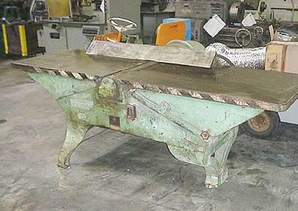

Sold on an on-line auction. Seller added the following:
Serial # 5773
Model # 300CM
Blade Length: 24"
Number of Knives: 4
Replaceable Type Blade Knives
Front Table Size: 32 1/4" x 49 3/4"
Rear Table Size: 32 1/4" x 44 3/4"
Front & Rear Tables Are Independently Adjustable
Guide Fence: 6 1/2" High x 53" Long
Floor To Table Top: 33 1/2" Approx.
EQUIPPED WITH:
Guide Fence is Adjustable for Tilt and Position on Table
Table Edge at Knife Area is Replaceable
Made of Heavy Duty Cast Iron Construction
NO Table Blade Guard
10 HP Direct Drive Motor, 3600 RPM
Wired for 3 Phase, 60 Cycle, 220/440 Volts
Presently Wired for 220 Volts
Overall Size: 98" L-R x 58" F-B x 42" High x Approx. 3000 Lbs.
