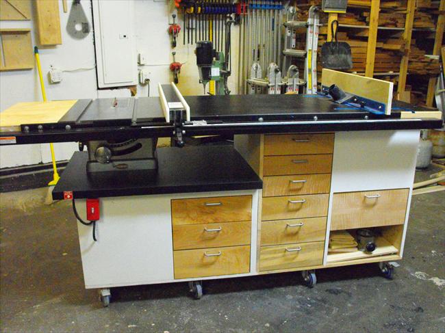

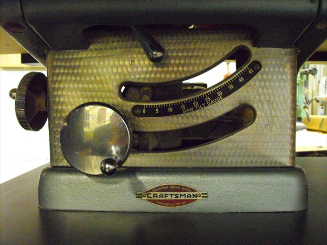

Was found and given to me from a dump (wow!) in Brookline, New Hampshire. There were only small rust spots on the table top, but otherwise it was in exceptional condition. I disassembled, degreased, stripped and repainted all of the components. The only new parts I added were new bearings on the arbor and knowing what this meant to me - and how I would be using it - a 2HP 110V capacitor start motor. I have a small shop and needed storage and mobility, so I built a rolling cabinet/drawer/router station/dust collection based on a 7 ft. Shop Fox fence that has been my workhorse and my best friend ever since. Best thing about this saw, is that it is identical to my Great Uncle's who was a WW1 vet and an incredible person on more levels than I can express. His saw was passed on to my father an was sold after many incredible projects - I guess it all comes back home.
Rehabed, tuned and in it's home. Used Rust -Oleum hand hammered paint to finish it, I think it works

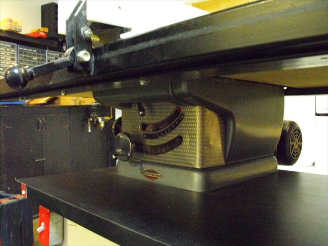

Under table view
Rolling cabinet - one more drawer and trim to go!

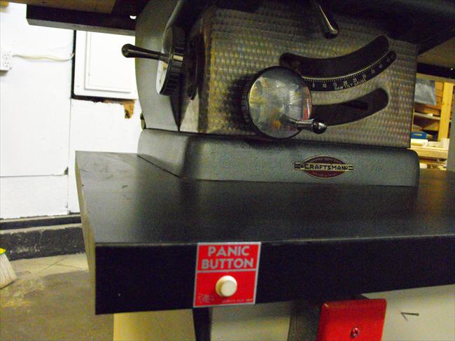

The most important button... and have replaced the switch with a paddle version since this was taken
