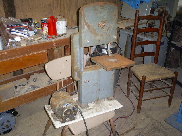

This is the saw as we got it.

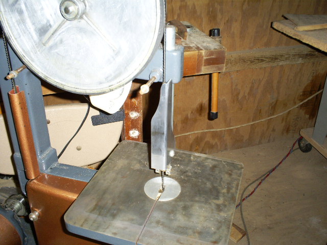

Completed except for the switch to be mounted and without the upper blade guard that I fabricated.

This is the blade guard fabbed from an aluminum bracket, cut to shape, and buffed out. Didn't see an upper blade guard on any other 9360's, but felt that this was a good addition to protect young fingers. Beside, it had a mounting screw there.

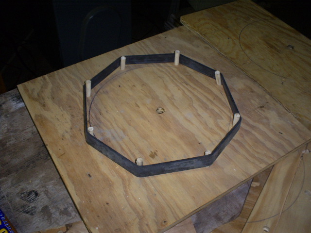

This is the jig I built to use to mount the new tires. We used contact cement to adhere the tire and my DeWalt MBF RAS with a homemade plywood disc and a 10" sanding disc glued to it to crown the tires. I set the RAS blade/disc angle to about 4 degrees.

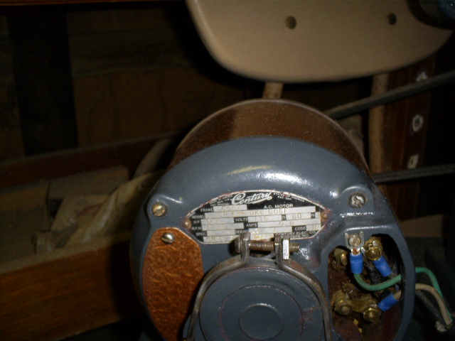

Here is the little 1/3 hp Century brass bushing, resilient mount motor. Still need to fab a little cover over the wiring terminals.
