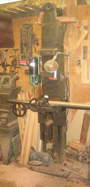

Yerkes & Finan Wood-Working Machine Co.
St. Louis, MO
Machine Type: Mortising Machine
Machine Size: 7' + tall
Submitted By: Kirk Poore
Description/Model: Converted solid chisel mortiser
Date of Manufacturer: 1890-1909
Serial Number: None
Last Updated 1/9/2010 5:04:40 PM
As seen at Dave Stine's shop. This reciprocating mortiser had it's operating mechanism removed sometime in the past. Dave took the head off of a little imported hollow chisel mortser and bolted it to the column. Now the raising table brings the work into the attached mortising head.
Comments: Converted mortiser. The table raises easily.
