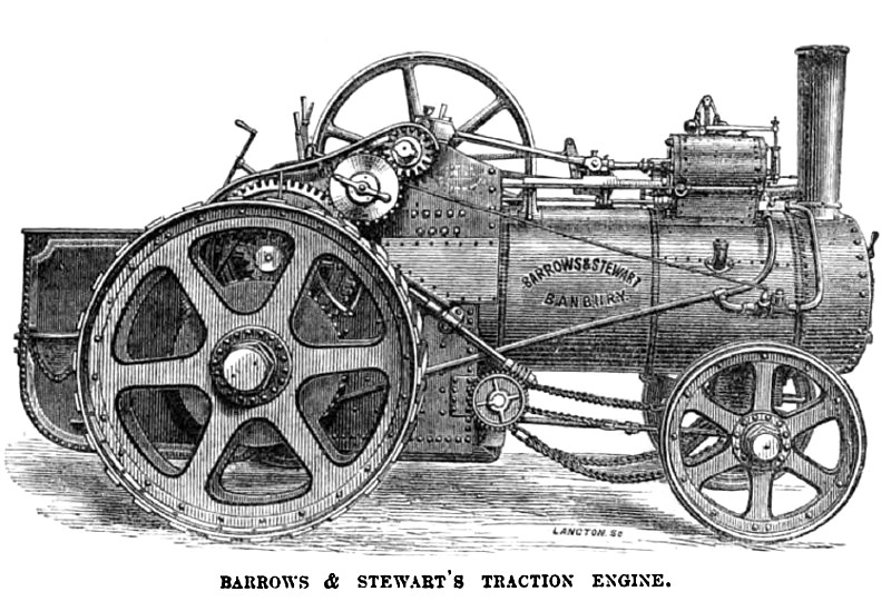

Our illustration shows a new traction engine which has been put upon the market by Messrs. Barrows 6: Stewart. The reader will notice that the cylinder is placed at the smoke-box end of the boiler, and we may state that it is steam jacketed. The crank shaft brackets are of wrought iron. and as they should be, are firmly screwed to the boiler. Steel has been wisely and judiciously employed. The gearing is of that metal and the engine is altogether a combination of strength and lightness. In addition to the usual stroke engine pump. the boiler is fed by an overhead patent injector. The traveling wheels are conspicuous for their serviceableness and power. As will be readily guessed, from the engraving, they are of wrought iron; and being steered from the footplate', the driver has the control of the movement. It is explained to us that the boiler is made of plates of the “best best” quality, and that Bowling iron is used in the fire box. All the necessary tools, with cover, &c., go out with the engine. This new traction engine of Messrs. Barrow & Stewart, of Banbury, is worthy to rank high amongst the most modern specimens of this class of road locomotive.
