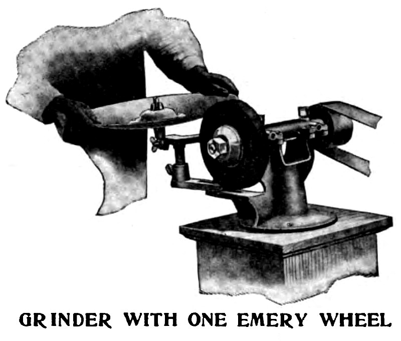

The emery-wheel grinder is made in two styles; the same frame or stand is, however, used in both types. As usually built, the device consists of a stand mandrel with two babbitted boxes at the top of the frame to carry the shaft. One end of the shaft is shouldered and threaded, so that by the use of flanges and nuts the emery wheel is securely fastened to the shaft. To the other end of the shaft is keyed the pulley by which to operate the grinder. A bracket is cast upon the stand that carries the support for the tool rest. This support and the tool rest are adjustable to the grinding wheel, as it becomes reduced by use. To the tool rest is attached a center rod and clamp used in grinding discs. This center rod is adjustable, so that discs of various diameter can be ground evenly and at exactly the desired angle.

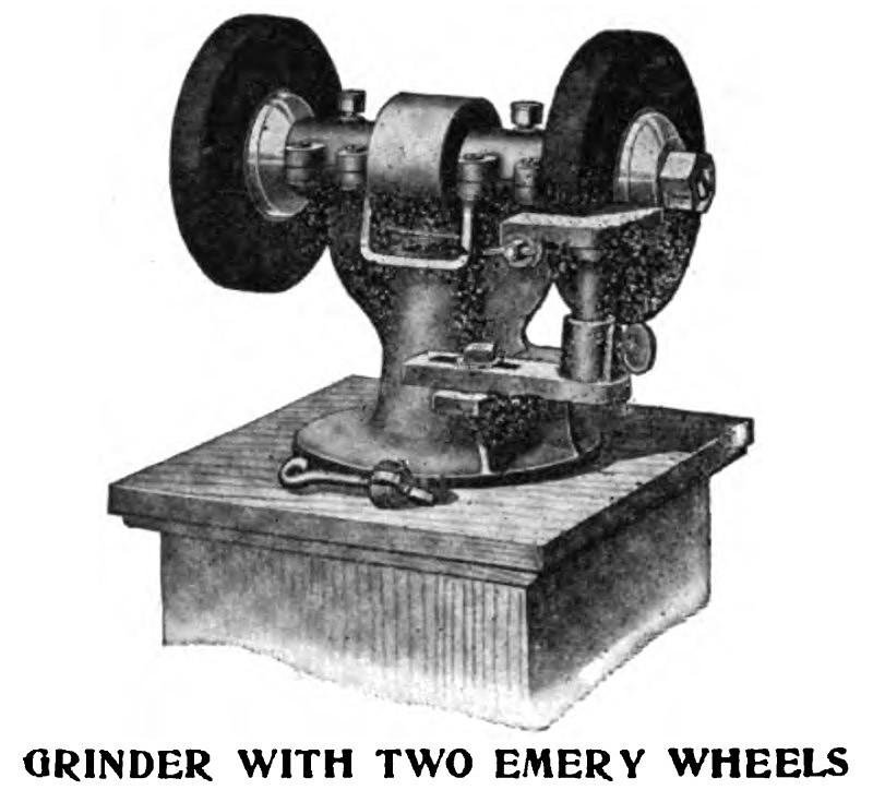

The other type of this device is similar to the one above described, except that the pulley is placed on the shaft in the center of the shaft, and a grinding wheel is furnished attached to each end of the shaft, one each, coarse and fine wheel, being furnished on the same frame. This enables the operator to do all rough work on the coarse wheel and to finish his work on the fine wheel.

1912 Duplex Mill & Manufacturing Co., Single Wheel Tool & Disc Grinder
1912 Duplex Mill & Manufacturing Co., Dual Wheel Tool & Disc Grinder
