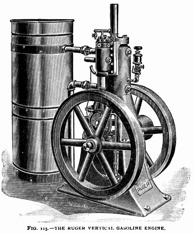

The Ruger gas and gasoline engines are built in the vertical style, as in Fig. 115, of 1, 2½, 5, and 8 B. H.P.; and in the horizontal style, of 10, 15, 20, 25, 30, 35, and 50 B.H.P. They are of the four-cycle compression type; are arranged for gas, gasoline vapor' or liquid, natural and producer gas. The gas engines have three poppet valves in two valve chambers, and the gasoline engines have only two poppet valves in one valve chamber.

1898 J. W. Ruger Mfg. Co., Vertical Gas Engine

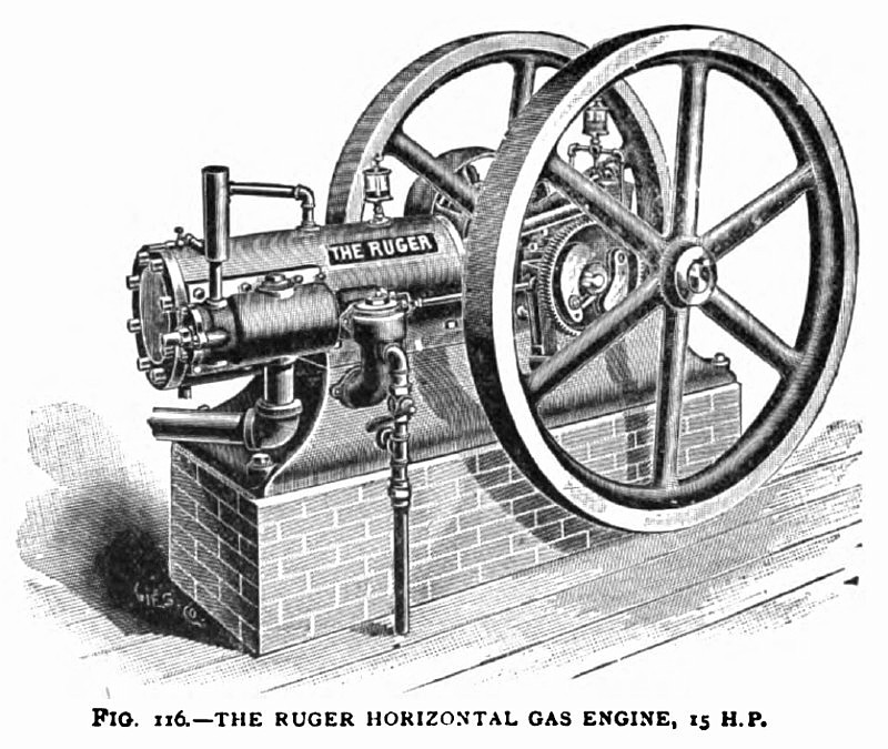

1898 J. W. Ruger Mfg. Co., 15 H. P. Horizontal Gas Engine

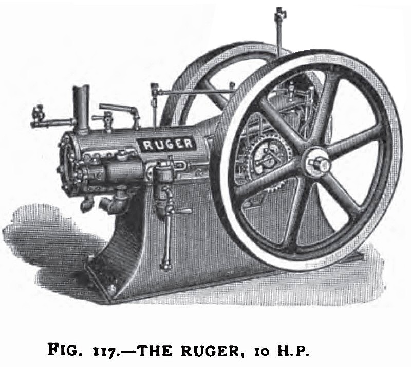

1898 J. W. Ruger Mfg. Co., 10 H. P. Gas Engine
