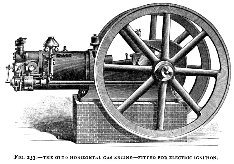

The gas-inlet valve is operated by a two-armed rocker shaft, one arm of which, carries a pin and traversing roller-disk, which is guided on or off the step cam by a forked bell-crank lever connected with the governor, thus controlling a variable charge. The electric or hot-tube igniter is furnished at the option of purchasers.
The electric spark is made by breaking contact of platinum electrodes, one of which is insulated in the head of the cylinder, the trip being operated on the outside by a swinging push-blade driven by an eccentric pin on the end of the valve-gear shaft.

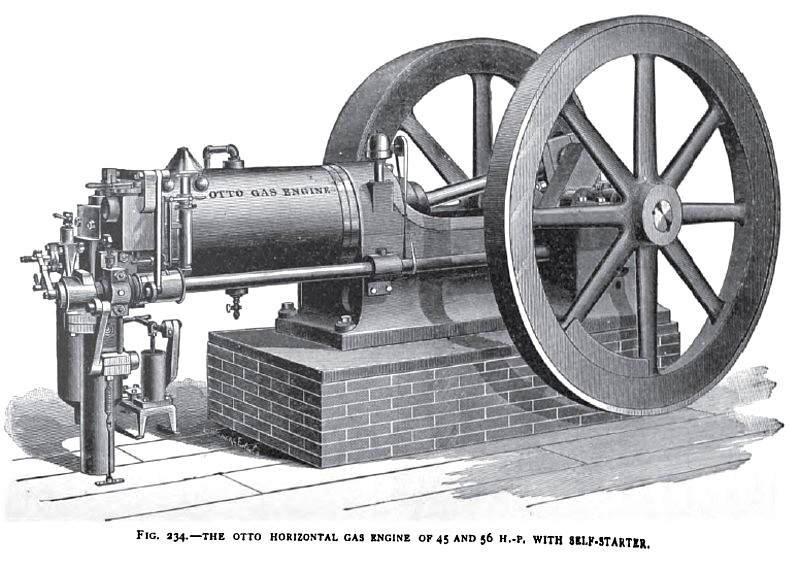

The horizontal engines are built in various sizes from 3½ to 100 horse-power. The vertical type of the Otto engines is built in a neat and compact form for both stationary and marine power—the single cylinder from 1 to 12 horse-power, and with double cylinders from 17 to 100 horse-power.
These engines are of the four-cycle Otto compression type, and equally adapted for the use of gas or gasoline fuel.
1898 Otto Gas Engine Works, Horizontal Gas Engine—Fitted for Electric Ignition
1898 Otto Gas Engine Works, Horizontal Gas Engine—With Self-Starter
