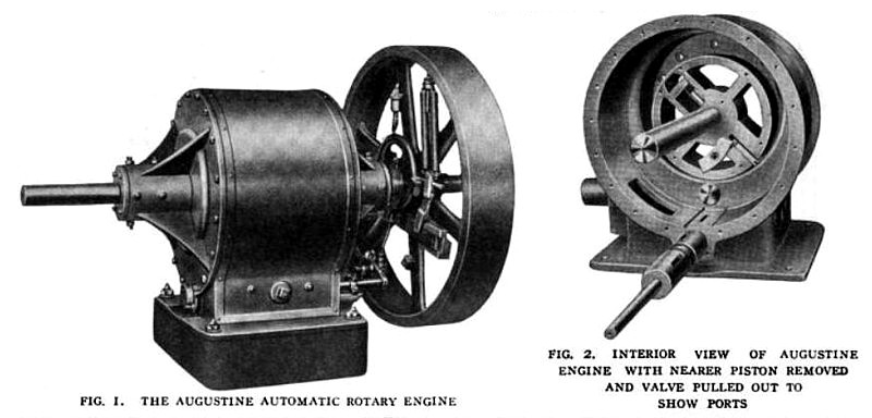

Illustrations herewith show the action of the engine and the design on which its success depends. In Fig. 1 is seen the assembled engine ready to run. It has a flywheel governor of special design which controls the speed accurately between no load and full load by changing the position of the eccentric.
This eccentric drives by means of an eccentric rod and rocker arm the oscillating valve, the driving mechanism being shown on the base of the engine in Fig. 1 and also at the bottom of the engine casing, Fig. 2. In Fig. 2, the ports through which the valve admits steam are in the bottom of the casing, one of them being seen where the revolving piston on the near side has been removed.

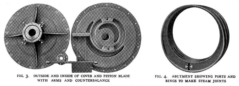

The ports in the casing are in line but the ports in the valve are staggered so that as the valve rocks back and forth steam is admitted first to one piston, then to the other. The pistons are mounted central to the outside casing, as shown in Fig. 2 and are held in this position by bearings in the heads, Fig. 3, these bearings being adjustable by means of set screws so as to keep the piston always bearing on the bottom of the eccentric abutment piece which forms the steam cylinder, this bearing being indicated in Fig. 2.
The abutment is shown by itself in Fig. 4, which also shows the ports for exhaust at the left and just the ends of the steam inlet ports at the right near the bottom.

In each piston is a counter-balanced blade seen in Fig. 1, the blade being at the lower right hand side of the piston and the counterbalance in a slotted arm of the piston at the upper left hand. This blade laps across the flanges of the piston so that the pressure of the steam seals them and makes a tight joint. These blades have, as shown in Fig. 3, a long arm on one side and a short arm on the other and on the ends of these arms, as shown in Fig. 2, are crossheads which run in grooves in the covers as indicated in Fig. 3, to keep the blades traveling central with the bore of the cylinder.

From this point of cutoff, expansion takes place and when the blade on one side reaches its uppermost position, the blade on the other side crosses the lower center and that piston begins to take steam. Thus one cylinder always has steam expanding while the other is taking steam at initial pressure. Steam exhausts without the action of a valve when the blade crosses the opening to the exhaust port shown in the abutment, Fig. 4.
