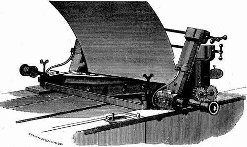

Our larger engraving shows the planing-machine with the spiral cutter in place. No alteration of the planer is necessary, as the spiral cutters fit into the same boxes and run with the same belts as the old. To test the efficiency of the machine, a series of trials were made, of which the following is a description:
In the experiments, one trial was made with an exchangeable head, the common head fitting exactly in the same place of the twisted or spiral head; it was the same head formerly used in that machine.
The spiral head was used without re-sharpening, and had evidently become partially dulled. The cutters in the old head were freshly ground and adjusted in the best condition. The spiral head beat the old head two to one; even with difference of condition against it.
Working in pine and gradually increasing the depth of the cut, the machine stopped with a shaving three eighths of an inch thick when the old cutter-head was used, but kept on to three quarters of an inch thick when the new spiral cutter-head was used.
Working in oak, it stopped at one quarter of an inch with the old, and at one half an inch with the new.
Working in walnut, it stopped at three sixteenths with the old, and one half an inch with the new, making a difference of more than one hundred per cent in the latter case. The pine lumber was sixteen and a quarter inches wide; the walnut seventeen and three quarters, and the oak eighteen inches; in every case the lumber compared was identical, and the belts and their tensions were the same.
In pine, the new cutter runs steadily and smoothly, taking off a shaving five eighths of an inch in thickness. We have seen it do the same thing in white wood.
The trials were fairly conducted, and showed a gain in the smoothness of the product, a. reduction in the noise, a reduction in the annoyance due to the shavings, and a very great increase in the capacity of the machine to plane bad stuff and to take a large shaving.
