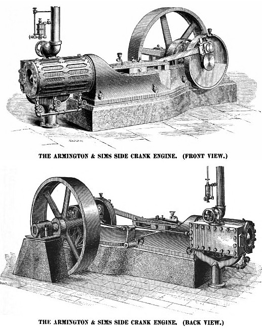

The Armington & Sims Engines, of which illustrations are shown on the opposite and on the page following, are built in several styles, to meet the various requirements of speed and power. The bed of these engines is of the well known Porter-Allen type, made very heavy, having interior longitudinal and cross ribs, thus ensuring the utmost attainable stiffness; the front cylinder head is independent of the bed, to which it is attached by studs fastened from the inside, thus easily allowing repairs to be made; the slide-bars have large surfaces, accurately scraped; the connecting-rod is of most approved form, and allowance is made for taking up wear of boxes; the main bearing is very large, and has adjustable cheek pieces; the disk of sufficient size to allow of the perfect balancing of the reciprocating parts; the crankpin is of steel, accurately ground, and of such size as to prevent heating; the shaft is of ample size to prevent springing, and is accurately ground at the bearings.
The steam-chest, with valve seat, is in one casting with the cylinder; the valve-chest is enclosed by a cover in the usual manner; this is a very desirable feature, as it enables the boring for valve and squaring up the ports to be accurately done, and it also gives an opportunity for the engineer to easily set the valve should it be necessary.

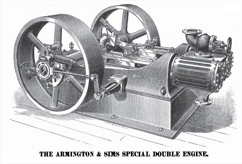

Armington & Sims build several other styles of engines, among which is their Special Double Compound. One of the desirable features as compared with engines of the single-acting type is the small space required. Being double-acting (that is, taking steam from both sides of the piston), it requires but one-half the piston area for same
power, and although the connecting-rods are all made 6 to 1, yet the floor space does not greatly exceed the upright single-acting type; for example—this 100-H.-P. engine has cylinders 9 1/2 inches diameter x 10 inches stroke, a single-acting engine running at same velocity and piston speed to give same power would require two cylinders each 13 1/2 inches diameter, and the length of engine, including wheels, must be considerably more than the width of this style. Of course in height there is all the advantage.
The governor used on this style of engine, which is built up to 250 horse-power, is the same as is used on their standard engines. The valve, which is an important factor in the economy of the Armington & Sims engine, is perfectly balanced, and surrounded at all times by live steam. By its unique construction it permits the full boiler pressure to be maintained in the cylinder up to the point of cut-off.

1890 Armington & Sims Co., Special Double Steam Engine
1890 Armington & Sims Co., Side Crank Steam Engine
