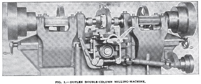

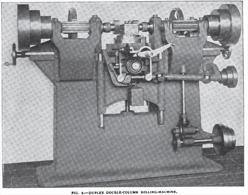

DUPLEX DOUBLE-COLUMN MILLING-MACHINE:
This is a modification of the Bogart Patent Double-Column Milling-Machine designed for the large class of work that can have two sides operated on simultaneously. Each head-stock is driven by a separate cone and gearing, although but one counter-shaft need be used. The use of long steel pinions, to engage with the gears on the spindles, makes possible the horizontal adjustment of the head-stocks with the minimum resistance. Greatest distance between the ends of the spindles 18-in., least distance, 3 ½ in. Vertical adjustment of the saddle 12 ¾ in. in the lowest position of the saddle the top of the table is 12 ¾ in. below the line of centers. The table is 9 9/16 in. wide. 46 or 52 in. long and has automatic power feed 25 or 30 in., according to its length.
1895 John L. Bogart, Duplex Milling Machine
