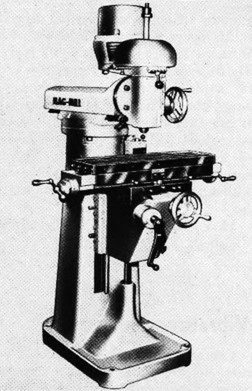

Only the magnetic Chuck mounted on the Vertical Mill was manufactured by the Hanchett Magna-Lock Corp.
Vertical Milling Machine
Holding of the workpiece by bolt or clamp is eliminated by the built-in electromagnetic table of this vertical milling machine. A d-c rectifier with manual reversing switch demagnetizes the table, workpiece, and accumulated chips, making it easy to remove the work and keep the table clean. Automatic demagnetizing is available. The table has a 7 x 27-inch work surface and 3 T-slots 11/16 inch wide and 2 1/8 inches apart. Longitudinal table travel is 16 inches, cross travel is 8 inches, vertical knee travel is 15 inches and vertical quill travel is 4 inches. Distance from spindle nose to table is 15 5/16 inches.
