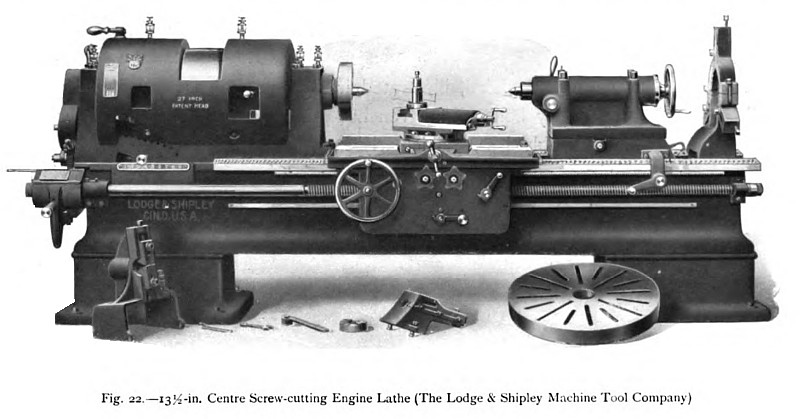

 Of the several interesting features embodied in the engine lathes of the Lodge & Shipley Machine Tool Company, Cincinnati, America, the patent headstock is probably the most noticeable, as will be evident from an examination of fig. 22, which illustrates the application of the head to a 27-in. swing lathe designed for the heavy speeds and feeds now required for the efficient use of modern cutting tools.

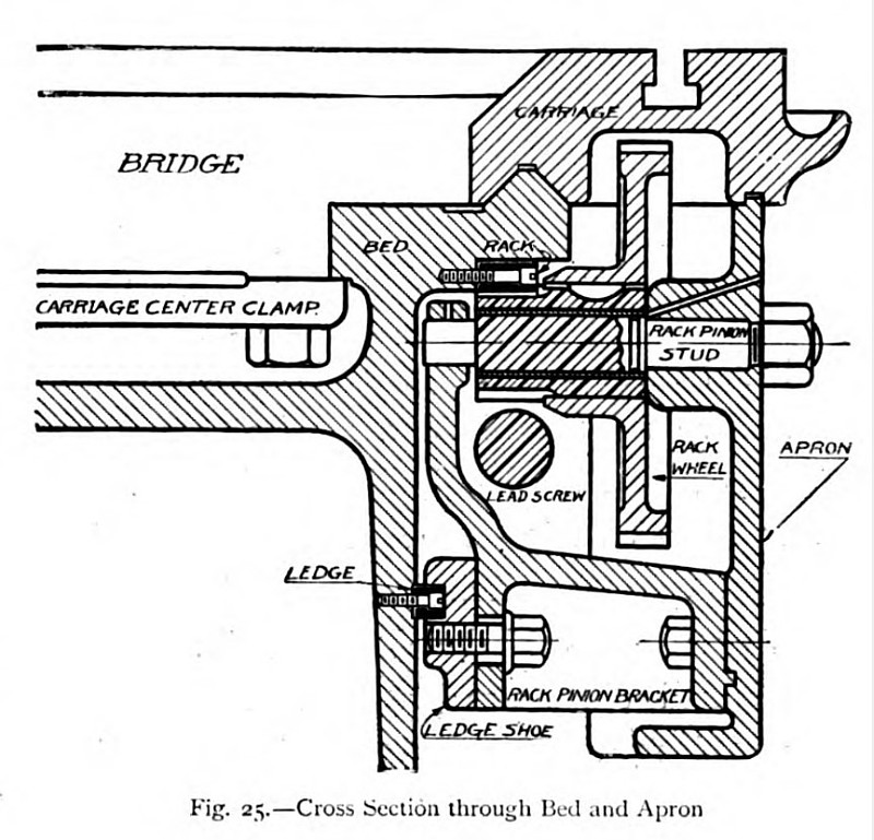

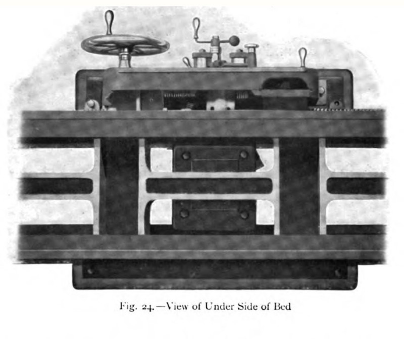

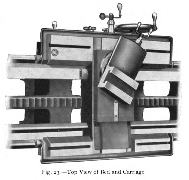

 The Bed. — Fig. 23 is a top view of the bed and slide rest, showing the rack, drop bridge, and shear wipers, while fig. 24 is a view of the underside. A cross section through the 42-in. apron and a portion of the bed is also given in fig. 25. From the general view of the lathe, and from the various illustrations referred to, it will be seen that the bed is of massive proportions, and that it is carried upon two box pedestals, which make the provision of specially heavy foundations unnecessary. By means of cross girths the bed is strongly braced internally, and the torsional rigidity thus obtained is considerable. From the section, fig. 25, and also from fig. 24, it will be seen that the carrier and tailstock clamps pass over the top of the cross girths, and that no clamping bolts pass through to the underside of the bed. In the case of the tailstock the clamping bolts project from the upper side of the head, where they are readily accessible. For the guidance of the carriage there are provided, along the front and the back edges of the bed, raised inverted V's with the tops well rounded off to prevent bruising. For the guidance of the tailstock, and the support of the fixed head, there is provided at the back of the bed an inside inverted V, and at the front an inside flat surface upon which the carriage also bears, as indicated in fig. 23.
 This arrangement, which is common to many modern lathes, permits the projecting portions of the carriage to pass the sides of the fast headstock, and thus enables the tool, mounted over the middle of the carrier, to be brought right up to the spindle head.
 All Lodge & Shipley lathes of more than 20-in. swing have, along the centre of their beds, a longitudinal rib or brace of box section, upon the upper surface of which is cast a rack, into which engages a pawl attached to the underside of the tailstock. This rack is clearly shown in fig. 23.
 The Carriage and the Apron. — As already mentioned, the carriage is supported along its whole length upon the front and back outer V's, and in addition the front inside fiat surface provides a direct support immediately under the tool. The bridge joining the front and back portions of the carriage is cast deep between the lathe shears; and, as gibs are provided for the removal of slackness, the possibility of appreciable springing of the carriage, when heavy cuts are being taken, is not great. The steel feed rack, by means of which the carriage is moved along the bed, is cut in one length, and is securely attached to a machined recess on the bed immediately under the front V guide. The pinion wheel, which engages with this rack, is carried upon the apron front plate, but the pinion stud, instead of being overhung, as is sometimes the case, is borne at its outer end upon a back plate or bracket, as illustrated in fig. 25.
 To prevent the rack and pinion from being forcibly sprung apart when the feeding force is great, the back plate of the apron is supported upon a steel ledge recessed into, and securely attached to, the front wall of the bed in a position practically in line with the direction of thrust between the rack and pinion. From the illustration it will also be seen that the lead screw is placed directly under the front guide of the carriage.

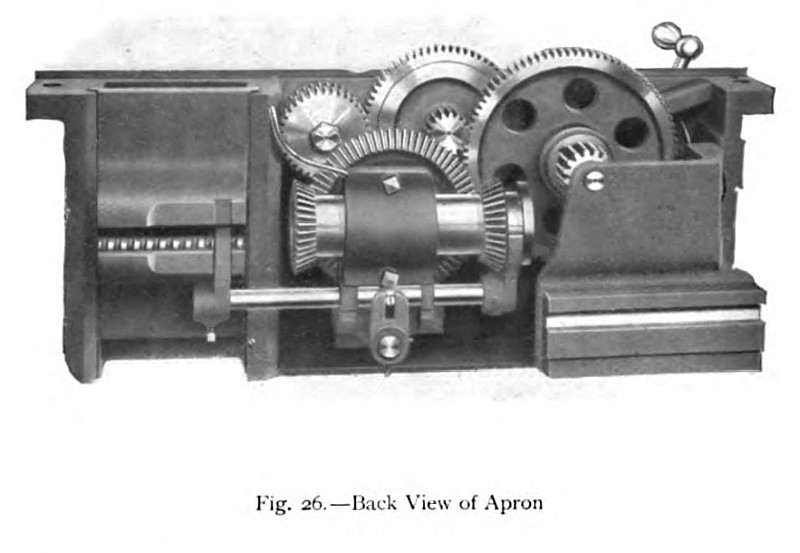

 A general view of the gearing carried on the back of the apron plate is given in fig. 26, from which it will be seen that the two halves of the nut, which can be made to engage the lead screw by means of a cam, are carried in stout vertical guides shown at the left side of the illustration. The threads of the lead screw are only in use when the lathe is screw -cutting, the ordinary longitudinal and cross feeds being effected by means of the double -bevel gear sleeve, the long key of which engages with a spline cut in the lead screw. A reverse lever on the front of the apron moves the double-bevel gear so that it meshes on the right or the left, and drives the carriage or the cross feed, as the case may be, in one direction or the other. When the feed is engaged, a finger connected to the reverse lever is automatically inserted in the path of the half-nuts, and thus the danger of the feed and screw-cutting gears being simultaneously engaged is avoided. As a further preventive against disaster, as for example when the carriage is allowed to overrun its travel, both the longitudinal and the cross feeds are operated by independent friction clutches, which slip before the breaking point of any portion of the gear is reached.
 Difficulty is often experienced in preventing grit from entering between the working surfaces of the shears and the carriage, and to overcome this trouble shear wipers and oilers are provided at the extremities of the carriage. As the carriage moves along the bed, the dirt is automatically wiped off and the surfaces oiled. A device of this simple nature helps to maintain the truth of the shears and the accuracy of the lathe.

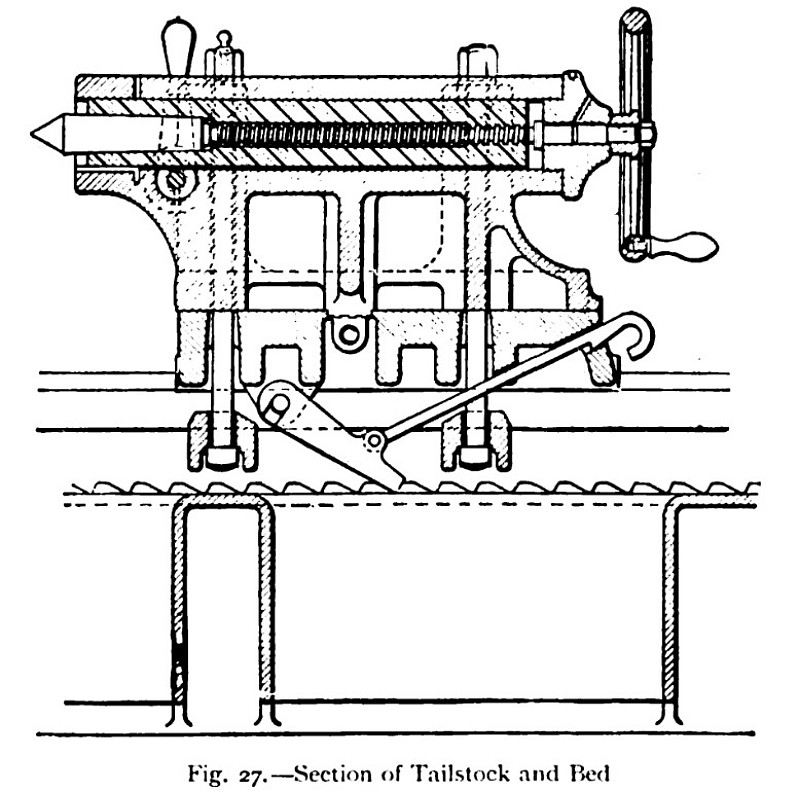

 The Tailstock. — Before proceeding to describe the headstock and feed gearing, some reference must be made to certain of the interesting features embodied in the tailstock, which is illustrated in section in fig. 27. Owing to the presence of the cross bracing of the bed, it is not possible to carry the clamping bolts through to the under side, and they are therefore carried upwards, as shown in the illustration, where the bolts are indicated at the top in a very accessible position. To the under side of the base there is hinged a pawl, which engages with the rack on the bed already referred to and prevents the tailstock from backing off when the lathe is doing heavy work, as sometimes occurs when the clamps alone hold the tailstock. To fix the spindle there is provided a cross-plug device operated by the handle near the nose. This split plug grips the spindle and holds it tightly without throwing it out of alignment. As is generally the custom, screws are provided for setting the tailstock transversely for taper work. When the weight of the tailstock is considerable, as is the case in the lathes of over 36-in. swing, a rack-and-pinion drive is fitted to enable the tailstock to be brought readily into position.
