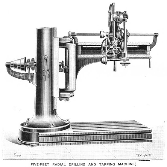

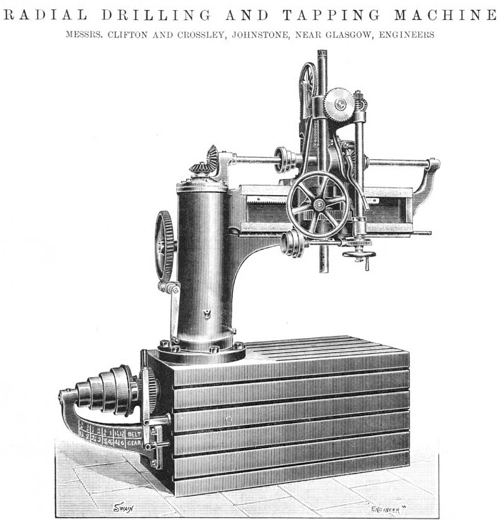

1896 article - Radial drilling and tapping machine
1896-09-11 The Engineer
