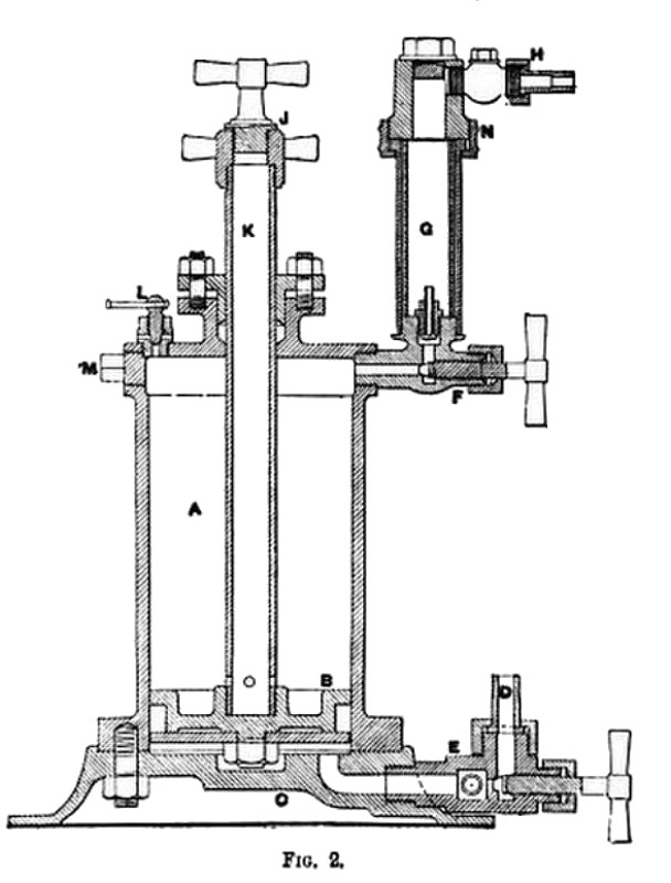

  In Fig. 2 A is the oil chamber, in which works a steam-tight piston, B, which is asbestos packed, having screwed into its top side a hollow steel piston rod, K, which works through a stuffing box. This piston rod also serves as an indicator showing the level of the oil. At the top end of the rod is a filling plug, J, through which the oil is delivered into the chamber A, the oil passing through the small holes at the bottom of the tube; D is the steam inlet, H the connection to the cylinder, G the sight feed, L an air valve, M a plug which can be unscrewed and the sight-feed G inserted, if required, at the other side, E is a run-off valve, and C is the base to which the lubricator is fixed.
  The method of working is as follows: When the piston B is at the bottom, and the chamber filled with oil, steam is admitted through the pipe D by opening the lower valve to the underside of the piston, the area of which is larger than the top side by the amount of the area of the rod K. This difference of area causes the piston to be raised within the cylinder, and so displaces the oil above, which finds its way out to the engine steam pipe or chest through the upper valve F, past the sight-feed G and connecting pipe H.
  The quantity of oil displaced can be readily regulated by adjusting the outlet valve to give any desired quantity. |

                                                            1888 Steam Cylinder Lubricator Co., Ltd., Steam Lubricator (Sectional View)
