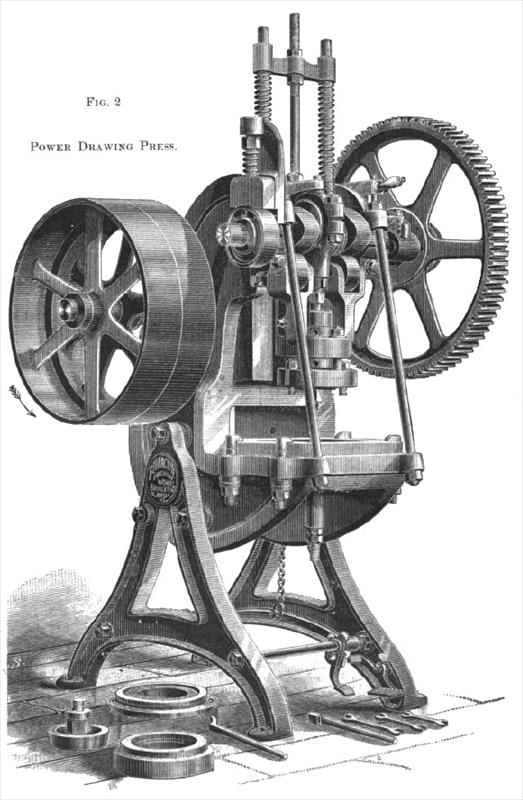

Fig. 2 shows a power-drawing press for making deep edged work in tin, thin sheet iron, copper or brass. It will cut and draw heavy lantern and lamp work, rim covers (for pails, &c.,) tea-pot breasts, butter dishes, pie plates, 1, 1½ and 2 quart (so called) milk pans, or any other work in tin, thin sheet iron, or brass, not more than 2 inches deep by 10 inches diameter, or if only 1 inch deep up to 12 inch diameter, one at a time. Where 2 blanks are drawn at once it will make up to 1 quart pans. The operation of the press is as follows: The outer and inner slide-bars descend together until the dies have cut the outer one, stopping as soon as the "holding" die reaches the blank, while the inner one, with the punch attached, continues to the bottom of its stroke. As soon as the work is done they both return to their upper position. The outer slide-bar is driven down by two steel cams resting on steel rollers, and the inner slide-bar or plunger by an eccentric which gives a positive motion in both directions. The springs (which are set with screw adjustments) merely raise the weight of the outer slide-bar, and as they arc amply large and long the slide-bar cannot "stick down." The plate on lower end of outer slide-bar, to which upper die fastens, is arranged with a screw sleeve for adjustment, and with three bolts which can be set separately so that the holding surface of the upper die is brought into a parallel plane with that of the lower, thus causing the work to be drawn evenly all around. The inner slide-bar or plunger is arranged so it can be revolved to any desired position and locked after the dies are set. This is a great advantage for o\al, square, or irregular shaped work. To those not acquainted with the "drawing" process it may be interesting to know that it consists in holding the "blank" of sheet metal between 2 flat surfaces under pressure (sometimes several tons), whilst the central descending punch draws it from between them in a conical or cylindrical shape, leaving the sides without wrinkles—the metal being "upset" or thickened circumferentially, and stretched or drawn out radially, as the outer parts are reduced in diameter.
