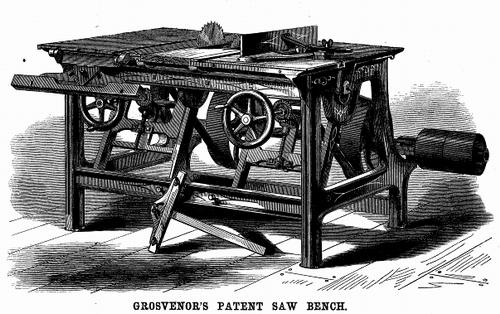

In 1868 Grosvenor patented a design for a tilting-arbor saw. His was not the first such patent, but he was very likely the first to successfully bring such a saw to market. Grosvenor's ads gave prominence to his line of tablesaws, and they seem to have been a commercial success.
Engraving of one of Grosvenor's tablesaw designs, from an 1868 article in Scientific American.
