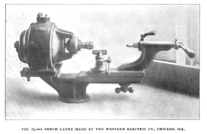

Early in the 20th century, this telephone and telegraph equipment maker made a curious direct motor driven bench lathe that appears to have been more of a "proof of concept" than a serious attempt to build a commercial product.
From the March 1905 "Cassier's Magazine"
