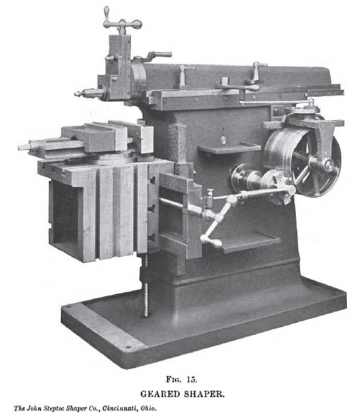

Geared Steptoe Shaper

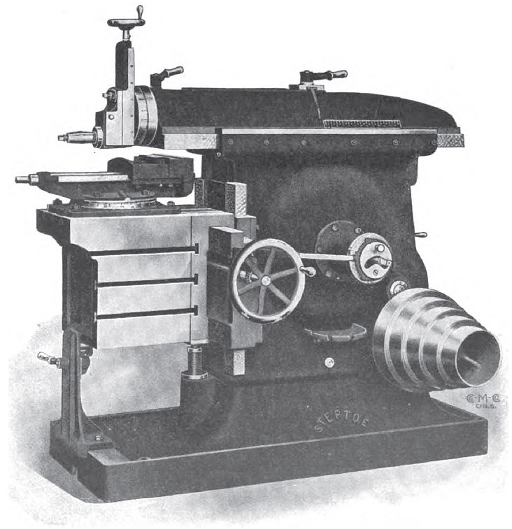

24” Steptoe Shaper

    In the new shop of the John Steptoe Shaper Co., Cincinnati, Ohio, there is an old gear cutter that seems oddly out of place among the other modern machine tools, but is only kept as a relic, its work now being done by a modern automatic machine.
    This cutter is of the type built along in the forties and fifties by the Putnam Machine Co., of Fitchburg, Mass., but whether they were the makers of this particular machine is not evident since there is no maker's name on it. The index plate is fixed upon the vertical work spindle on which were mounted the blanks to be cut, which might be both spur and level, since the machine was originally adapted for both. The index plate is about three feet in diameter and contains fully 18,000 holes, all of which were probably laid out, and drilled without the aid of a jig. The outer row contains 'M holes and there are 51 circles in all. The number of holes and the arrangement differ somewhat from the old Putnam gear cutter of the same type illustrated in the October, 1897, issue of Machinery. That machine had 468 holes in the cuter circle and 52 circles, making a total of 15,690 holes. As stated, the machine is retained as much for its association with the past as any other reason, the John Steptoe Shaper Co. being the oldest machine tool builders west of the Allegheny Mountains. In this connection it may be of general interest to give a short history of the concern which was written at our request:
