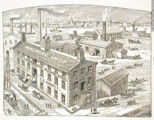

Image of the Leeds Foundry from an 1879 book
Beginning in 1858, E. E. Abbott was the proprietor of the Leeds Foundry of Gananoque, Ontario, and a maker of woodworking and metalworking machinery, including a wood-frame tablesaw; the business variously used Abbott's name and the foundry name for its products. In 1871 the named changed to Leeds Foundry & Machine Works. For a couple of decades the business was large and prosperous. Then in early 1889 the name was changed to the Economy Engine & Machine Co. of Gananoque, then a little more than a year later the business was sold to George Gillies, a local manufacturer of agricultural implements such as harrows and cultivators as well as carriage hardware, nuts, bolts, and other hardware specialty items. In 1891 the Economy Engine & Machine Company was dissolved, presumably being absorbed into Gillies' main business, which in 1893 incorporated as George Gillies Co., Ltd. So far as we can tell, all of the old product lines were abandoned with the change of ownership to Gillies.

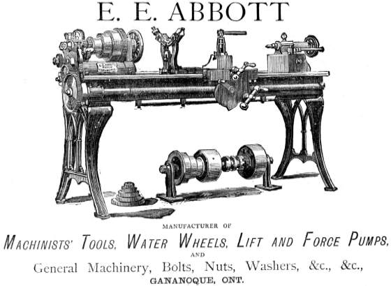

  • 1869 The Province of Ontario Gazetteer and Directory has a text ad: "E. E. Abbott, manufacturer of Machinists' Tools, Power Presses & Special Machinery, —Also— Water Wheels, Mill Gearing, Wood Working Machinery, &c., and Merrill's Telescopic Lift and Force Pumps, Bolts, Nuts, Washers, Letter Presses / Bench and Jack Screws, &c., &c., Gananoque, Ontario."
  • Lovell's Canadian Dominion Directory of 1871 lists Elijah E. Abbott of Gananoque as "manufacturer of machinists' tools and general machinery &c., U. S. Consular agent. See adv p. 7".

    Mr. E. E. Abbott was born in the State of Connecticut, and at an early age turned his attention to mechanical pursuits, acquiring a thorough knowledge of mechanics, not only theoretical, but also practical. In 1855, he removed to Canada, and was engaged as Superintendent of iron works at Kingston. Having examined the special advantages of Gananoque as a manufacturing centre, he removed to that place in 1858, and opened a shop in a part of the old Globe Works. His business extending, he, in 1871, built the "Leeds Foundry and Machine Works," shown in the accompanying illustration. The establishment is situated on the west side of the Gananoque River, and is convenient to the St. Lawrence, by which machinery can be shipped with facility.
    The machine shop is a stone building, three stories in height, with fire-proof roof, and having at area of 42x98 feet. The foundry is 40x68, and the smith's shop 55 feet in length, the buildings forming three sides of a parallelogram. The entire factory is fitted up with the most complete labor-saving machinery, and the work turned out is second to none in Canada. It includes steamboat fittings, agricultural implements, iron and wood working machines, planers, presses, etc.—in fact every variety of castings, and labor-saving utensils. Mr. Abbott's business relations extend to every portion of the Dominion, thus demonstrating the superiority of the articles manufactured by him.
