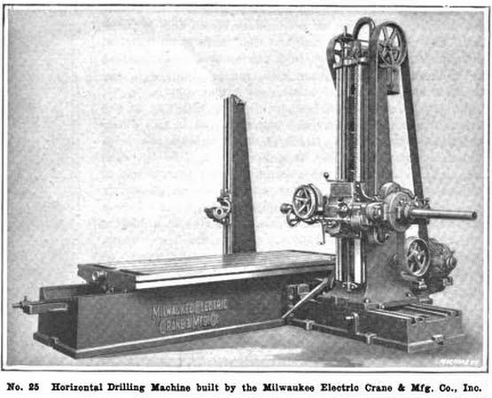

![](images/19421-A.jpg) |
Illustration from article in February 1920 Machinery |
Around 1918, the Milwaukee Electric Crane & Mfg. Co. made a horizontal drilling and boring machine, sort of a radial drilling machine stood on its side. We have also seen a 1929 and a 1931 mention of Milwaukee Electric Crane & Hoist Corp., and it appears that by that time they were no longer making their drilling and boring machines.

- 1919 Wright's Milwaukee City Directory lists "Milwaukee Electric Crane & Mfg Co Inc S H Squier Pres; M A Beck V-Pres-Chf-Eng; Arthur Fritsch V-Pres-Sales-Mgr; M P O'Brien Sec-Treas; A A Mayer Asst-Eng; C L Mayer Chf-Drftsmn; Mfrs Electric Travelling Cranes and Hoists and Horizontal Drilling and Boring Machines 60th and Greenfield Av".
- 1920 Iron Age Catalogue of American Exports has two pages on the Milwaukee Electric Crane & Mfg. CO., "Manufacturers of Horizontal Drilling and Boring Machines". The factory and a couple of horizontal drilling machines are illustrated, and specifications are given; see the "Publications" tab for a PDF of these pages.
