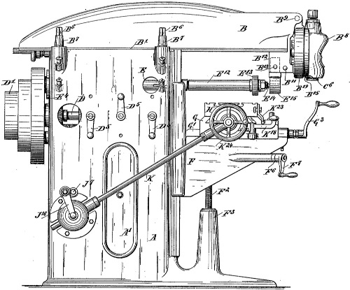

Patent drawing for Mergenthaler's universal milling machine |
In 1891 another company was formed, the Mergenthaler Linotype Co. of New Jersey, to take over the rights to the Linotype machine. After the successful introduction of the machine, Mergenthaler applied his inventive genius to developing a series of machinery for making the matrices, which are the type-molds, one per character, that are assembled to create the mold for a line of type. While developing these machines he also developed and patented a milling machine adapted for more general production use. Beginning about 1898 the Ott. Mergenthaler Co. began manufacturing and selling his innovative universal milling machine with geared feed. Production continued for only a short time before ceasing in favor of milling cutters, adjustable reamers, and taps that we suspect were developed by Mergenthaler in the course of working out the manufacturing process for his Linotype machine and the matrices.
