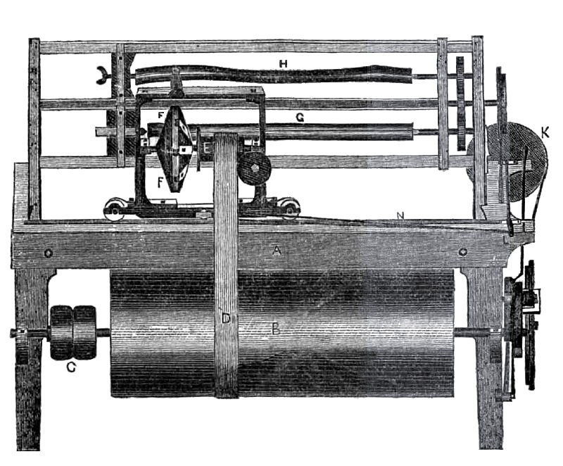

His greatest invention was his machine for turning irregular forms, originally patented in 1819 (no. X3,131), and extended until 1862. It was originally intended for gunstocks, but was subsequently used for axe handles, piano legs, cricket bats, shoe lasts, spokes, wig stands, and countless other irregular but smooth objects. Blanchard's machine used a slowly-rotating pattern to move the spinning cutter in and out as the work rotated in unison with the pattern; at the same time, the cutter and the pattern-follower gradually moved along the horizontal axis of the lathe.
Blanchard's machine for turning irregular forms, from 1848-09-09 Scientific American
