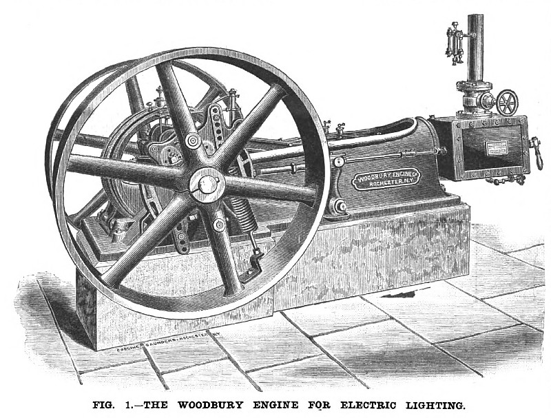

                                                    | Recognizing the high qualities demanded of an engine employed in electric lighting, both as regards economy and regulation, the Woodbury Engine Company, of Rochester, N. Y., have designed several sizes of engines constructed upon the general type of that shown in the engraving, Fig. 1.
 The engine, as will be seen, is of the self-contained, single valve type, and the regulation is effected by an automatic cut off. Two centrifugally acting weights are employed, to one of which the eccentric is attached. The centripetal, or opposing force, is furnished by a single spiral spring, the two weights being connected by a link. The chief characteristic of the governor is in the adjustment, which enables the centrifugal and centripetal forces to be so balanced at all positions that the fluctuations in speed from light to heavy load and with great ranges in steam pressures, are confined within very small limits. This is accomplished in the following manner: The link which connects the spring to the main weight has a series of holes in the weight itself, as shown in Fig. 1. There are seven holes, and the sustaining pin, which takes the strain of the spring, fits through any hole in the weight and the corresponding hole in the link. By shifting the pin, therefore, the tension of the spring can be varied at will and its sensibility increased to such a point that the travel of the valve and admission of steam shall correspond exactly with the load.

 The shaft and pin are formed in one solid forging and the counter-balancing discs are held to the cranks wrought iron clips passing around the cranks and secured with nuts. The cranks are turned off at the end for the discs, which are bored out to fit, and the discs are therefore removable, and when replaced will run true.
 All the parts of the various sizes of this engine are designed with a view to durability and economy, and the engines already in operation are said to give excellent results. The Stott Woolen Company, of Stottville, N. Y., have one of them driving its electric light plant, at a speed of 300 revolutions per minute: size 8 X 12. The Edison Company, at Rochester, has ordered one 16 x 20 to run at 200 revolutions.
                                                             1887 Woodbury Engine Co., Steam Engine for Electric Lighting
