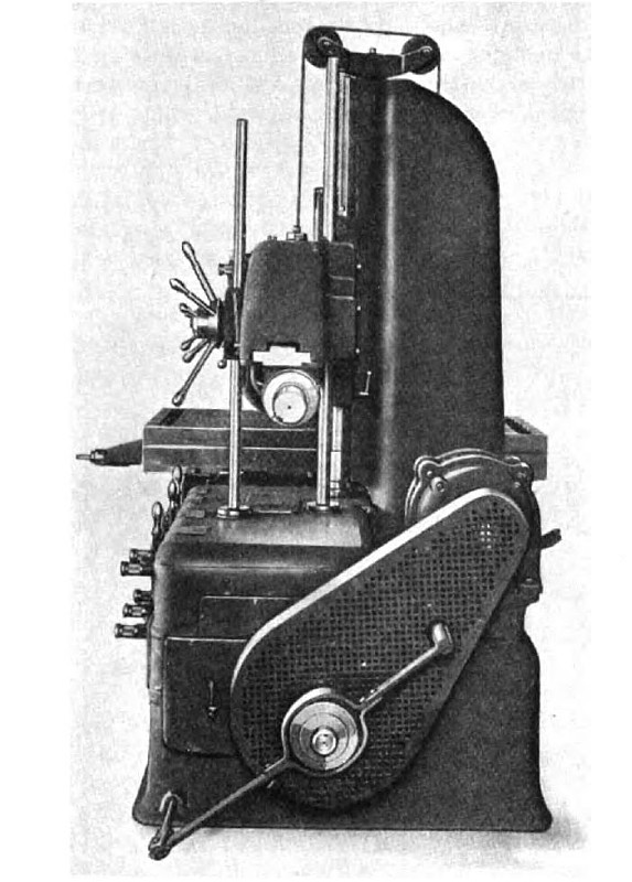

 Wear of the rear post elevating screw may be compensated for by means of the nuts at the upper end of the screw. Prom the end view of the machine shown in Fig. 2, the method of mounting the driving motor may be readily observed. A few of the principal dimensions of the machine are as follows: Automatic travel of main boring-bar, 30 inches; travel of main boring-bar by resetting, 60 inches; size of table, 30 by 63 inches; power cross-feed of table, 48 inches; power longitudinal feed of carriage, 40 inches; power vertical feed of head, 30 inches; maximum distance from table to center of boring-bar, 30 inches; and greatest distance from faceplate to outer support, 72 inches.

  1922 Universal Boring Machiine Co., Horizontal Boring Machine (End View) |  |
