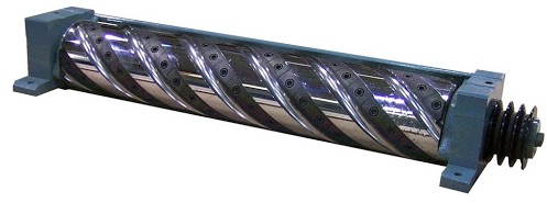

In early 1970 Newman Machine Co. attempted to reduce noise levels in its planers. They were unsuccessful in their attempts until they partnered with the Center for Acoustical Studies at the North Carolina State University. Subsequent research found that the primary noise source is vibration of the board as it is being planed, and that that vibration could be considerably reduced by using a shearing cut and by keeping at least two knives cutting at any instant. These insights led to the development of the Quietcut cutter-head, which used segmented carbide cutters in a tightly-wound helical arrangement. The Quietcut achieved a tremendous 15 to 25 dBA reduction in noise levels. The Quietcut was very successful in commercial shops.
Newman Quietcut cutterhead, introduced in about 1974
