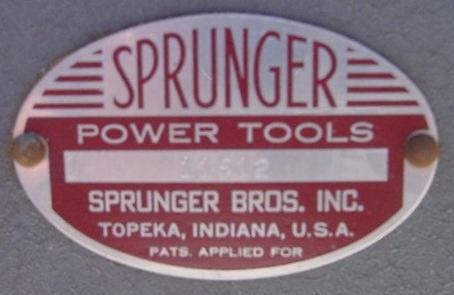

SERIAL NUMBER DATA (EXCLUDES TABLE SAWS WITH LARGE SINGLE PRINTED FRONT PLATE)
From Serial Number
To Serial Number
Year
200-500
200-3000
1947
200-3000
200-7000
1948
200-7000
200-12000
1949
12000
15000
1950
15000
18000
1951
18000
21000
1952
21000
25000
1953
25000
27000
1954
27000
30000
1955
30000
33000
1956
33000
35000
1957
35000
38000
1958
38000
40000
1959
40000
42000
1960
42000
44000
1961
44000
46000
1962
46000
49000
1963
49000
52000
1964
52000
55000
1965
55000
58000
1966
58000
61000
1967
61000
64000
1968
64000
68000
1969
68000
71000
1970
71000
74000
1971
74000
78000
1972
78000
82000
1973
82000
85000
1974
85000
88000
1975
88000
91000
1976
91000
95000
1977
